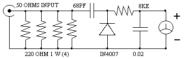

    Here is a simple set up which will enable them to measure the out
    put power of their transmitter. All that they require is a good
    multimeter which has a sensitivity of 20k ohms/4 Watts which is adequate
    for low power transmitters. Many beginners trying out their skill with
    QRP TX, for the first time have to overcome many problems before they
    are able to come on the air. On usual complaint is that, every thing is
    working fine but the signal is not going out.
    The 8k resistor should be kept close to the out put terminal of
    the transmitter. Switch on the transmitter in the CW mode and measure
    the DC voltage with the multimeter. If the voltage is V then the out put
    power is given by Power = V^2/50
