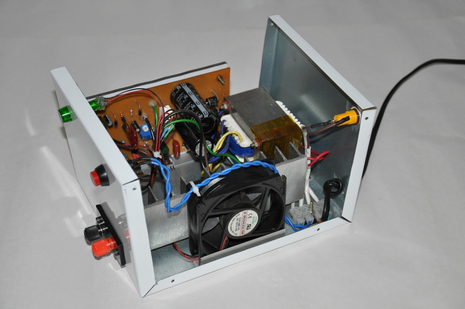

The prototype version of 13.8V - 5A power supply unit.

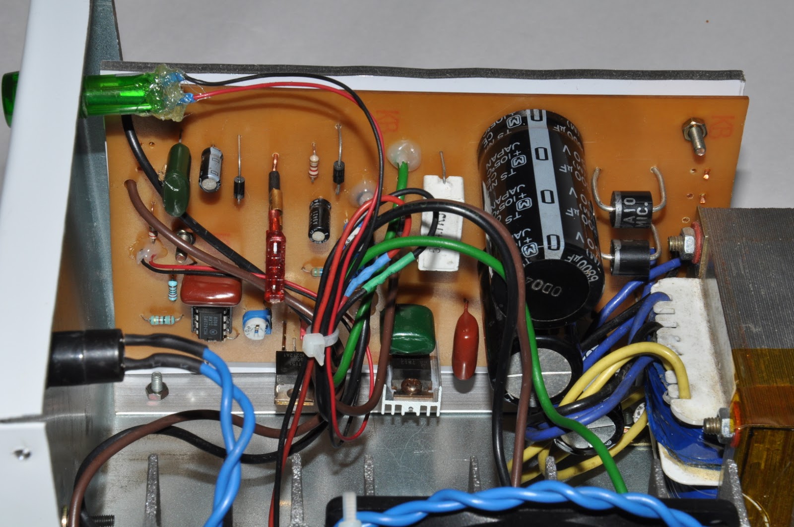

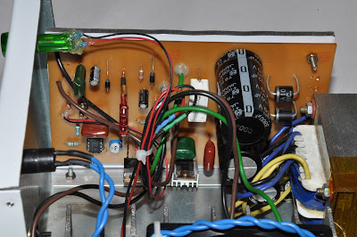

The printed circuit board of the power supply unit
In our prototype version, we mount LM338K on 50mm × 155mm × 3mm heatsink. To cool this heatsink we use above mentioned 120mm 12V (100mA) cooling fan.

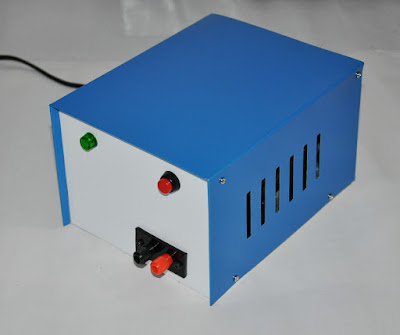

The finished prototype of 13.8V - 5A power supply unit.
