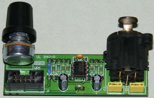

    Photo of Completed Board
    As you can see, the board uses a PCB mounted XLR connector and pot, so is a complete mic preamp, ready to go. Feel free to ignore the terminals marked SW1 (centred between the two electrolytic supply caps), as they are specific to my client's needs and are not useful for most applications. The original use was to use them for a push-button switch that activated an audio switch via a PIC micro-controller. They are not shown on the schematic.
    The DC, GND and output terminals may be hard wired to the board, you may use PCB pins or a 10-way IDC (Insulation Displacement Connector) and ribbon cable. Power can be anything between +/-9V and +/-18V with an NE5532 opamp. The mic input is electronically balanced, and noise is quite low if you use the suggested opamp. Gain range is from about 12dB to 37dB as shown. It can be increased by reducing the value of R6, but this should not be necessary. You will need a linear pot for VR1 because anti-log (reverse log) pots are very difficult to obtain. The gain control is not especially linear, but unfortunately in this respect there is almost no alternative and the same problem occurs with all mic preamps using a similar variable gain control system.

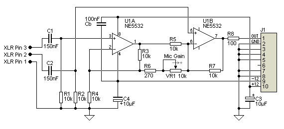

    Figure 1 - Preamp Schematic
    The circuit is quite conventional, and if 1% metal film resistors are used throughout it will have at least 40dB of common mode rejection with worst-case values. The input capacitors give a low frequency rolloff of -3dB at about 104Hz. If better low frequency response is required, these caps may be increased to 4.7uF or 10uF bipolar electrolytics. These will give response to well below 10Hz if you think you'll ever need to go that low. Note that VR1 should be linear or reverse log - do not use a log (audio taper) pot as it will be uncontrollable at high gain settings.
    Note that VR1 is not a volume control, and it cannot reduce the signal level to zero. It's a gain control, and allows you to set the gain of the preamp to account for different microphones or sound levels. As noted above, minimum gain is 4 (VR1 at maximum resistance), and maximum gain as shown is 78.
